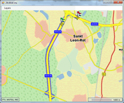

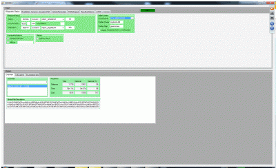

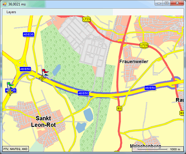

after receiving some comments from Andreas I made some tests. My plot:
  • xRoute : 1.18.0.0
  • the profile: mg-truck-40t
  • map: EuropeCityMapPremium-2013.1aN

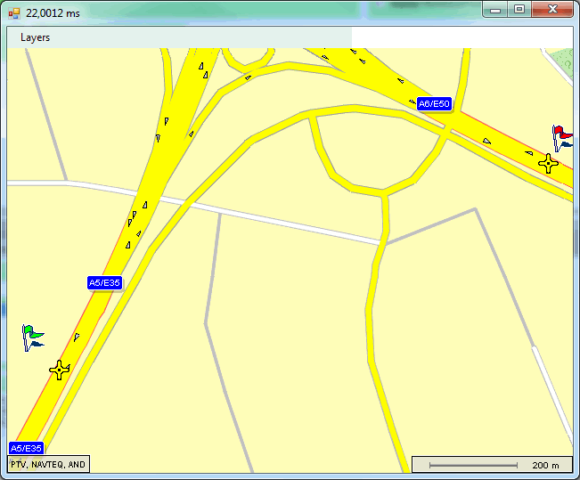

  • plot: some coordinates near a german highway in suboptimal locations
    the waypoints near the highway
The used profile mg-truck-40t uses the property headingTolerance="45.0" which is not set in the default profile.
With this setting the waypoints heading in my samples is used:

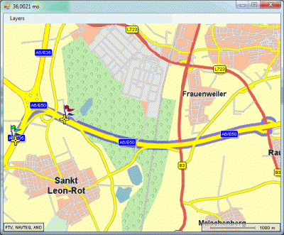

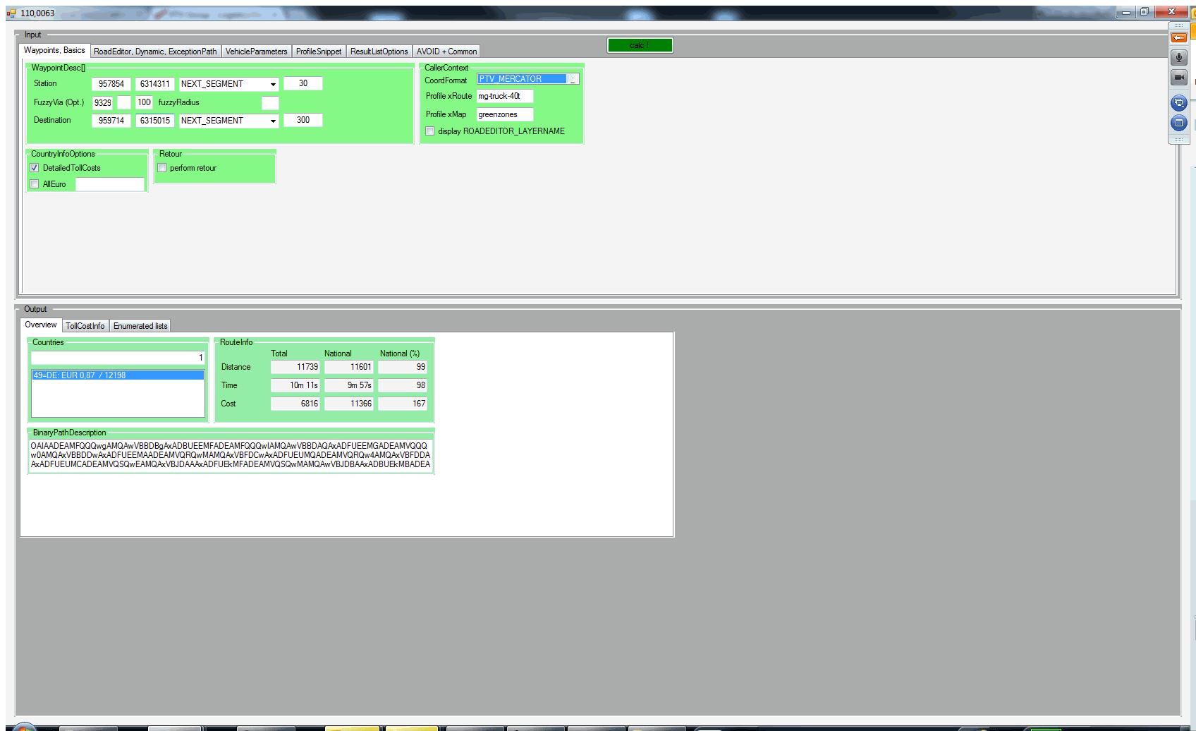

Sample 1:
start 190, destination 120

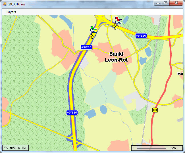

Sample 2:
start 30, destination 300
As you can see the link to the street segment of a waypoint has positive or negative impact as desired.
Regards Bernd
