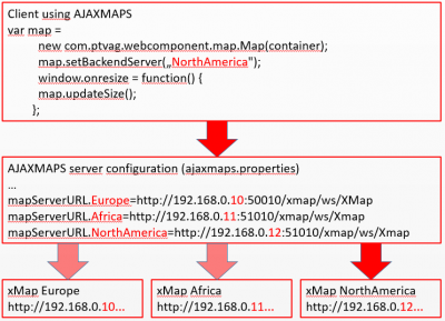

Hello there,
these days a customer asked me whether it is possible (and how) to switch between various xMap backend URLS while using just a single installation of the AJAXMAPS. The solution is based on a combination of server configuration and a single statement in the JavaScript call.
In this example the AJAXMAPS instance is configured to deal with three logical backends. Depending on the map.setBackendServer(..) the user faces another map backend.
