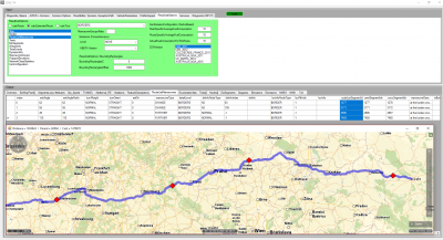

Re: Border Crossings
Posted: Mon Jan 07, 2019 2:56 pm
Hello Max,
how about the Manoeuvres list?
Watch out for the BORDER-Manoeuvres. They link to the segments you might be looking for. And the segments coordinates are available via the reference to polygon points
Posted: Thu Jan 10, 2019 3:37 pm
Hello max,
check the arrays - the poilygon ontains the coordinates.
The segments refer to the polygon.
The Manoeuvres refer to the segments.
https://xserver.ptvgroup.com/fileadmin/ ... %7C_____60
