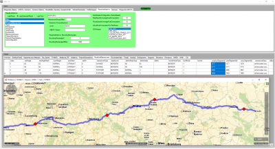

Re: Border Crossings
Hey Bernd,
sorry > I am having problems to get the solution.
According to your example:
How can I find out the coordinates of the first border-crossing?
I do not know how to refer to the coordinates I receive ( the 1277th planpoint [lat/lng] > ?).
Maybe you know what I am doing wrong?
Max

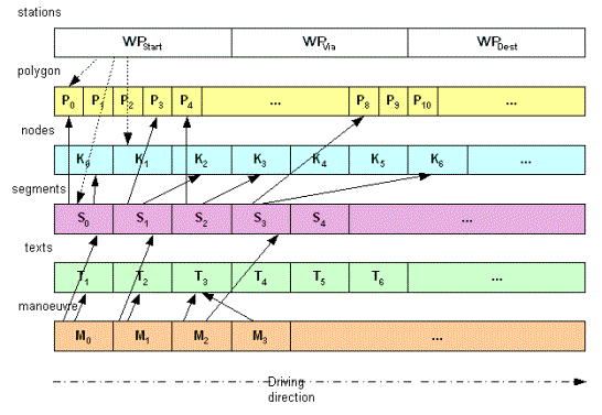

Hello max,
check the arrays - the poilygon ontains the coordinates.
The segments refer to the polygon.
The Manoeuvres refer to the segments.
