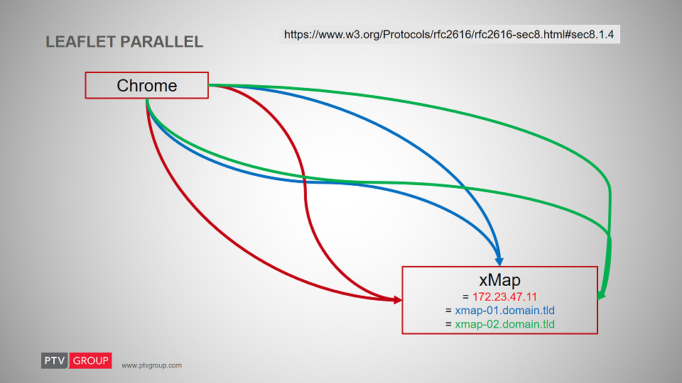

From what I heard about leaflet is that it (more precise: the browser) limits the number of parallel connections to further URLs to a defined threshold value. Therefore a mapping framweork such as LEAFLET can only consume a number of tiles at the same time in parallel. In times of "full display mapping" a frontend requires 50-100 tiles and I'd like to speed up the rendering process.
Imagine we have a backend xMapServer (cluster) with sufficient number of backend modules:
Does it make sense to add further logical names to perform a "detour"? This approach could reduce rendering time by a factor 3 ;-)
Same logical backend service is assigned to several "different" names
Any experience in the crowd?
https://www.w3.org/Protocols/rfc2616/rf ... l#sec8.1.4

IMO the difference running xMap with 1 modules vs 2 modules is noticeable in the end user experience. However if you would upscale to 4 modules and thus 2 logical names for the host I find the difference becomes less noticeable. Even if the xServer is not in the local intranet (for example you are using xServer internet) most sites I visit often have a good enough internet connection that it doesn't make a noticeable difference.
My common advise is to start without multiple logical names and later you can always add this to your code if users still find the map sluggish.
