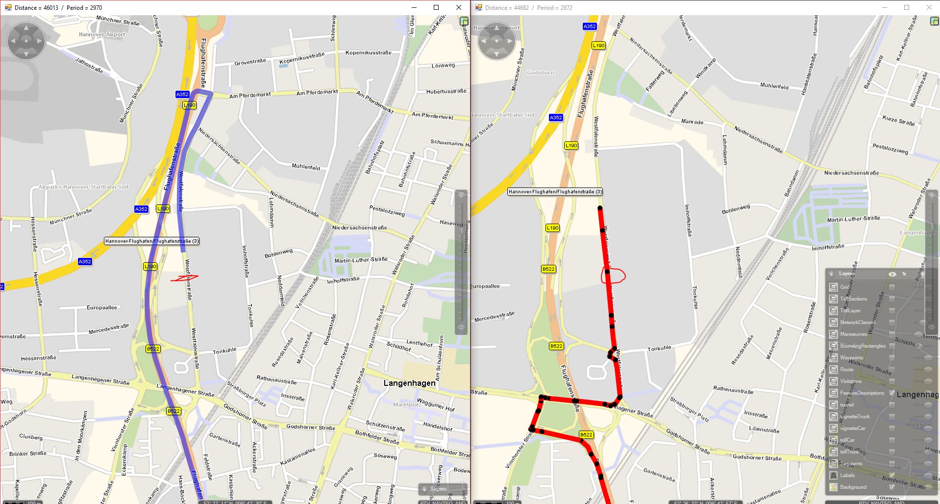

that's indeed weird. Your track is shown as a 22 days trip for about 45 km.
The cause for the behaviour appears at the beginning of your trip.
The third segment in the list is a long term construction I think.
right: static track. Enforced by &quot;dynamicTimeOnStaticRoute&quot;. Running straight into the full block caused by some construction.<br />Left: proper detour ;-)
right: static track. Enforced by "dynamicTimeOnStaticRoute". Running straight into the full block caused by some construction.
