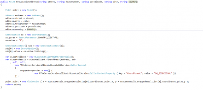

I'm new to xServer Api. I want to get the waypoint from the address.
I found out it, I only have the Luxembourg map (60 day trial).
Can I change that?
Other question is, I've the postalcode format for Luxembourg as L-3274
The api cannot find any waypoint for that postalcode.
What do I have to do?
Kind regards, adriaan

Hello Adriaan,
If you have registered for an xServer internet test account you should have access to the full Europe map on our test cluster. Which URL are you using when you call xLocate?
About the postal code format:
xLocate 1 is rather strict about the postal codes and want official way of writing witch is without the letter + dash. You have to "clean" the postal codes yourself in your business logic. XLocate 2 is a bit more relaxed on this point. Have a look at https://xserver2-europe-eu-test.cloud.p ... /index.htm and you can try out some of your data.
PS their is a bug in your code when you create the search options. You never copy the param attribute from you earlier defined option. Easier would to be to just use that option:
var sob = new SearchOptionBase[] { so, };
