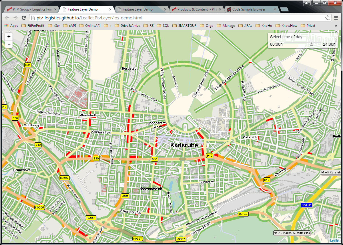

Hello guys,
today a WKB (= well known buddy) provided a sample implementation of our new generic approach called FeatureLayer to me. The sample is available at Oliver's git hub and looks like this:
Level of Service sample
Though the sample doesn't cover routing based on the daytime data the xRoute is also able to consider this level-of-service within the computation.
The core mechanism that is used for the visualization is the so-called FeatureLayer which enables us to access additional data such as
  • level-of-service based on daytime (historical data) also known as "traffic patterns"
  • truck restriction zones
  • time zones
  • preferred routes
both for rendering and routing. With the upcoming 1.20 version of the servers we will provide a codesample in the CodeSampleBrowser as well. But for now take Oli's eyecatcher ;-)
Additional content is available for [urlhttp://xserver.ptvgroup.com/en-uk/developer-zone/customer-area/ptv-xserver/product-download/#c2638]download in the restricted area[/url] after login.
From a technical point of view you have to take a look at the XML snippet mechanism to make use of this data in a regular xmap / xRoute request.
Oli also provides the source code.
Feel free to provide feedback about this FeatureLayer via the forum,
Thanks to Oli - you are my guru!

Put a sample with speed-patterns routing on GitHub: https://github.com/ptv-logistics/fl-labs
Sample: http://ptv-logistics.github.io/fl-labs/
