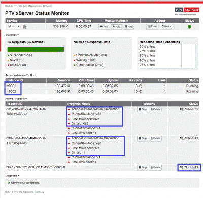

Is it necessary to reuse the existing distance matrix or is it an option to create independent DIMA IDs for the planning calls?
As you can see with this status monitor image it is possible to use two independent DIMA IDs in parallel while the third one is in the queue.<br /><br />My poolsize is two of course
