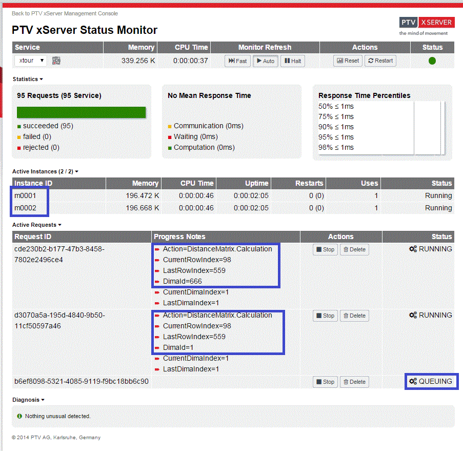

As you can see with this status monitor image it is possible to use two independent DIMA IDs in parallel while the third one is in the queue.<br /><br />My poolsize is two of course

Hello Bernd,
Thank you for your quick reply. Solved my problem.
I was deleting the existing distance matrix on every call (DistanceMatrixByRoad.deleteBeforeUsage=true), but on all requests I was always using the same dimaID.
Now I’m generating different ID’s for each call and it is working fine. Thank you.
