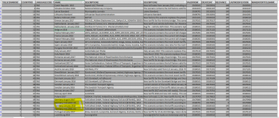

And for your information: the relevant scenario meta data is available in the TollScenarios.INI in your map folder.
You might use this info to check (manually) what validity periods are given:
TOLLSCENARIOID;COUNTRYID;LANGUAGECODE;NAME;DESCRIPTION1;DESCRIPTION2;VALIDFROM;CREATEDAT;RELEVANCE;LASTMODIFICATION;MANDATORYTOLLNAME
Sample of the TollScenarios in my environment.<br />Reduced to ENG descriptions.  Shows 4 scenarios for Germany (49). Some are marked as FORECASTS.
