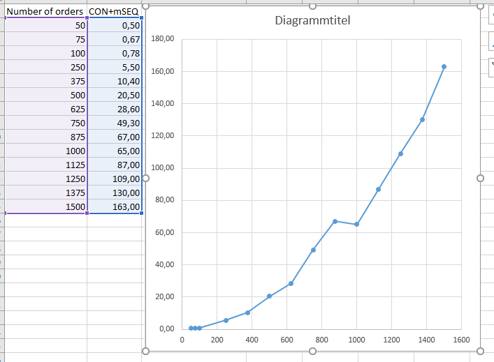

I made a very, very simple comparison of various planning scenarios with different number of orders. What they have in common:
  • No time restrictions on the orders or vehicle
  • Just one single vehicle
  • No need to return to the depot (sufficient capa)
  • Construction and MiddleSequencing have been applied (improvement would blow the termination time at least for a quick test)
According to Frank the performance grows in cubic style. If the construction phase is "successful" the performance should even be less than cubic.
Some sample response times
As Joost mentions: try to keep the number low. Especially with a groupage of 30 per order you can win performance.
