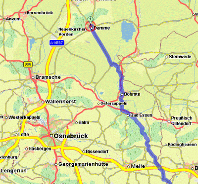

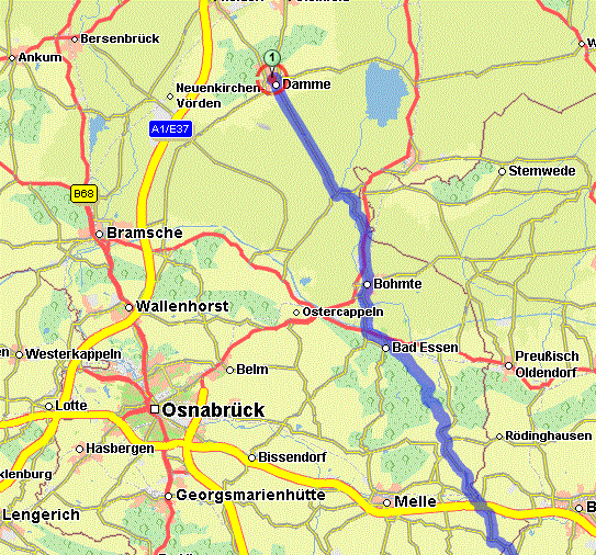

Using this options PTV Map&Guide Internet calculates a route of 522 km with travel time 8h 27min.

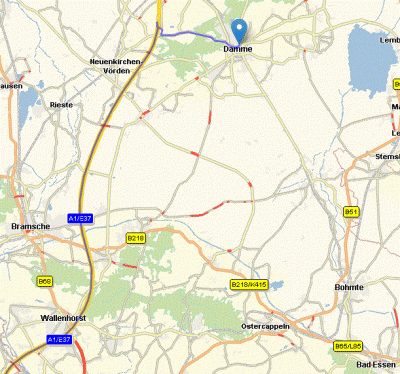

When calculating with the same options using the Java API I get 554 km and a travel time of 8h 4min.
The first difference is at the start of the route. Map&Guide Internet travels directly down from Damme to Bohmte not using the highway A1.
The Java-API goes directly to highway A1.
Why is there such a difference in the route calculation and what could be the difference in the settings?

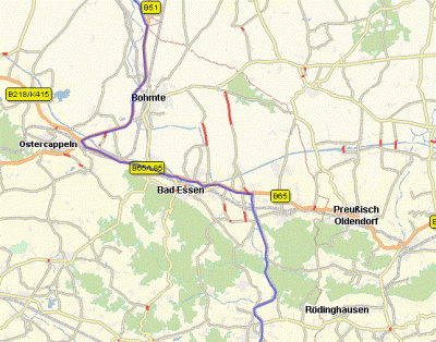

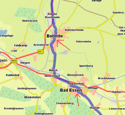

After setting the optimization to 40% also the Java-API calculates the first part of the route from Damme to Bohmte. But the Java-API then avoids to travel through cities.
while Map&Guide Internet uses cities...
What could be the cause of the different calculation of the routes?
