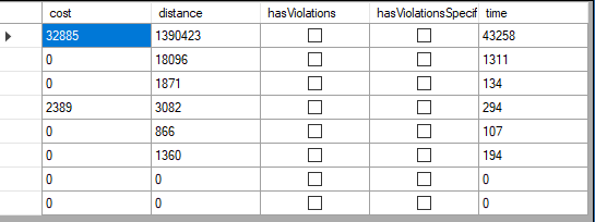

aggregating the distances and periods per NC is simple, just use the property perNCRouteInfo of the CountryInfo and sum them up in the way you like:
Information about distance and time per network class.
Additionally the cost field of the RouteInfo object holds the toll distance. Please note that these distances may differ in some countries (e.g. Germany) from perTypeTollDistance as they are based on the routing calculation and not on the official distance tables provided by the government, which are not available per network class.
This fragment of C# code will give you a list of driving times, distances, ... per NC in all the countries that are passed:
ExtendedRoute extRoute = svcRoute.calculateExtendedRoute(lstWPD.ToArray(), null, null, rlo, cio, null);
RouteInfo[] arrRouteInfo = new RouteInfo[8];
for (int i = 0; i < 8; i++)
    arrRouteInfo[i] = new RouteInfo();
    foreach (CountryInfo ci in extRoute.wrappedCountryInfos)
        RouteInfo curRouteInfo = ci.wrappedPerNCRouteInfo[i];
        arrRouteInfo[i].cost += curRouteInfo.cost;
        arrRouteInfo[i].distance += curRouteInfo.distance;
        arrRouteInfo[i].hasViolations = arrRouteInfo[i].hasViolations || curRouteInfo.hasViolations;
        arrRouteInfo[i].hasViolationsSpecified = arrRouteInfo[i].hasViolationsSpecified && curRouteInfo.hasViolationsSpecified;
        arrRouteInfo[i].time += curRouteInfo.time;
Sample output of a route from Gothenburg (Sweden) to Karlsruhe (Germany) via Hamburg (Germany)
