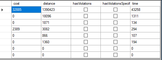

aggregating the distances and periods per NC is simple, just use the property perNCRouteInfo of the CountryInfo and sum them up in the way you like:
This fragment of C# code will give you a list of driving times, distances, ... per NC in all the countries that are passed:Information about distance and time per network class.
Additionally the cost field of the RouteInfo object holds the toll distance. Please note that these distances may differ in some countries (e.g. Germany) from perTypeTollDistance as they are based on the routing calculation and not on the official distance tables provided by the government, which are not available per network class.
ExtendedRoute extRoute = svcRoute.calculateExtendedRoute(lstWPD.ToArray(), null, null, rlo, cio, null);
RouteInfo[] arrRouteInfo = new RouteInfo[8];
for (int i = 0; i < 8; i++)
arrRouteInfo[i] = new RouteInfo();
foreach (CountryInfo ci in extRoute.wrappedCountryInfos)
RouteInfo curRouteInfo = ci.wrappedPerNCRouteInfo[i];
arrRouteInfo[i].cost += curRouteInfo.cost;
arrRouteInfo[i].distance += curRouteInfo.distance;
arrRouteInfo[i].hasViolations = arrRouteInfo[i].hasViolations || curRouteInfo.hasViolations;
arrRouteInfo[i].hasViolationsSpecified = arrRouteInfo[i].hasViolationsSpecified && curRouteInfo.hasViolationsSpecified;
arrRouteInfo[i].time += curRouteInfo.time;
}Bernd

i played a bit and it's working fine so far
But there are the network classes 0 - 7 only, I guess it's mapped like that:
//0 - Autobahn
//1 - ?
//2 - Bundesstraße
//3 - ?
//4 - Kreisstraße
//5 - Innerorts
//6 - ?
//7 - ?
Is there any documentation about which class means what? (at least for Germany)
