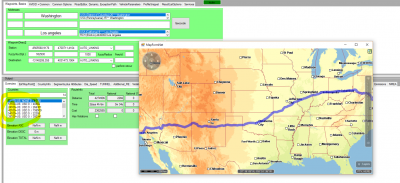

- example screenshot of a route in US traversing various states. The issue is that the returned IU codes aren't sufficient without a matching table IUcode<=>state
We deal with the routing in the USA and one info we retrieve from the xRoute server is the toll.
According to the API documentation the toll info's are assigned to INTEGRATION UNIT CODES but what we really need is the code of the STATE.
Is there a matching list of IUcodes 2 state code?
