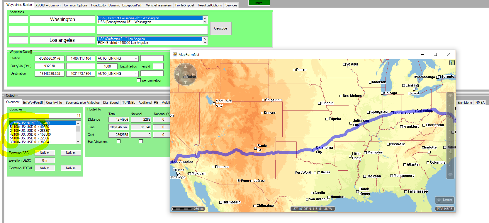

We deal with the routing in the USA and one info we retrieve from the xRoute server is the toll.
According to the API documentation the toll info's are assigned to INTEGRATION UNIT CODES but what we really need is the code of the STATE.
Is there a matching list of IUcodes 2 state code?

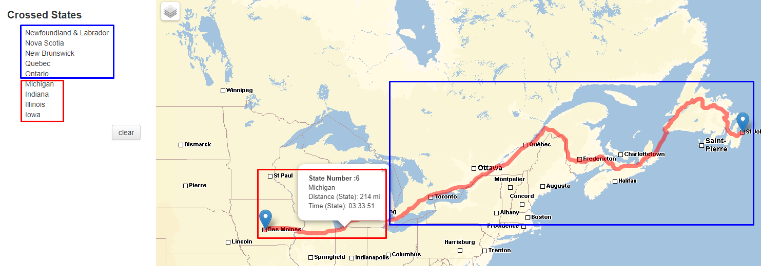

This use case is pretty common for US customers that want to evaluate their fuel tax (IFTA), it requires mileage per states.
I built a geojson file from various source on the web, and a little bit of edition to match the PTV sub unit code to the actual state name.
I'm now able to retrieve the mileage per state (US and CAN)and the states boundaries, Mexico return the same IUCode (752) for the whole country.
