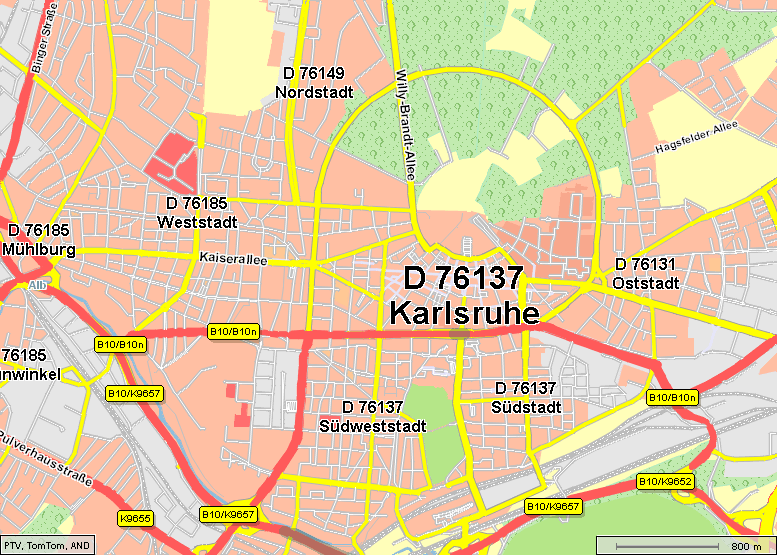

But: another potential cause is the scale as you can see on the following image:
The town label does not represent a postcode area but the whole town!

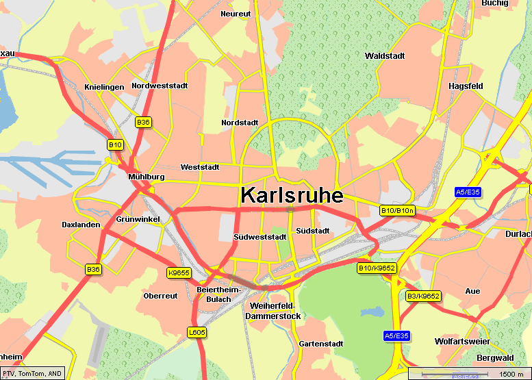

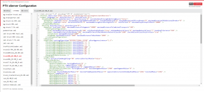

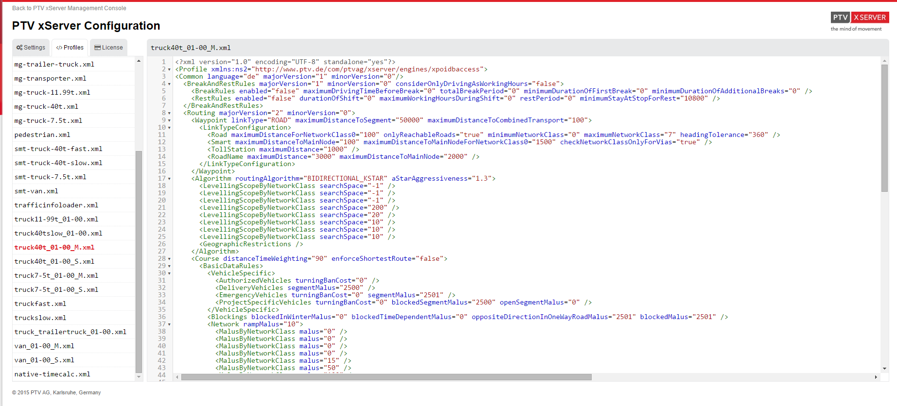

Please check http://127.0.0.1:50030/pages/configurator.html on the running xRouteServer.
Look at the profiles:
This page should display several available reference profiles: To activate such a profile use the CallerContext / CallerContextProfile with key="Profile".
