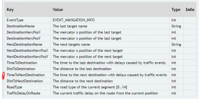

investigating the remote Interface i see no possibility of fetching the described information about the calculated ETA or any other detail information about a route calculated by the navigator. Maybe its hidden implicitly or i just overlooked this feature.
Can you be a bit more explicit about which function to use? That would be great!

Hello Eike,
please check out the event types here: http://navigator.ptvgroup.com/DE/remote ... types.html
you can listen to any of these events and with that gather Information from the navigation.
PS: we don´t offer the ETA, we offer the duration of the tour (which you can use to calculate the ETA with based on the current time)
