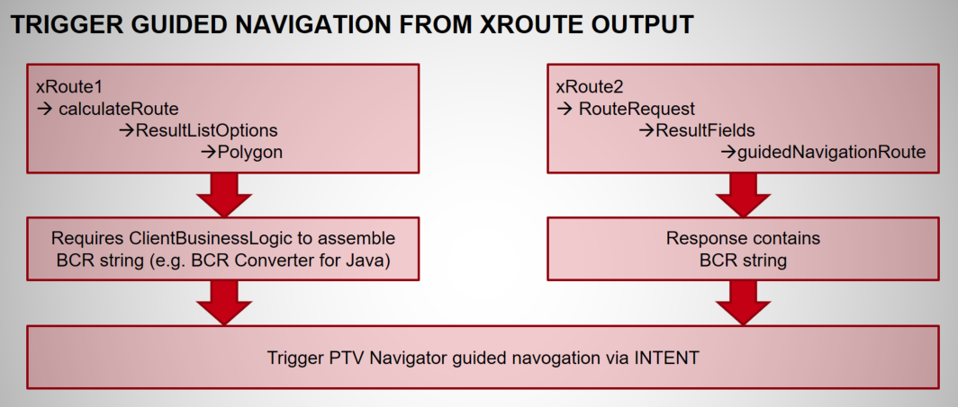

in the meantime xRoute 2 offers to return the BCR as direct output from the route response: But: please be aware that this feature is experimental so far, i.e. there might be changes in the API (renaming, change of type, even removing).

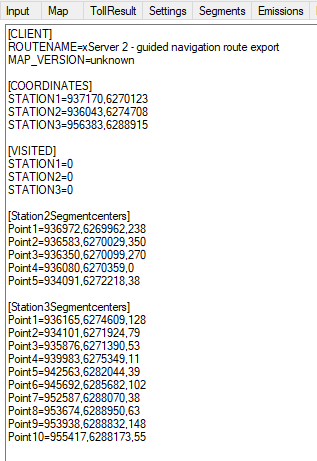

Here's a sample xRoute2 request that consumes the built-in guided navigation
The response is encoded as BASE64 so you need to decode it on clientside, e.g. in C#:
"waypoints": [
"$type": "OffRoadWaypoint",
"location": {
"offRoadCoordinate": {
"x": 6.22029,
"y": 49.61513
"location": {
"x": 6.06479,
"y": 49.62127
"resultFields": {
"eventTypes": [
"MANEUVER_EVENT"
"guidedNavigationRoute": true
}Code: Select all
Encoding.UTF8.GetString(routeResponse.guidedNavigationRoute)Bernd Welter
