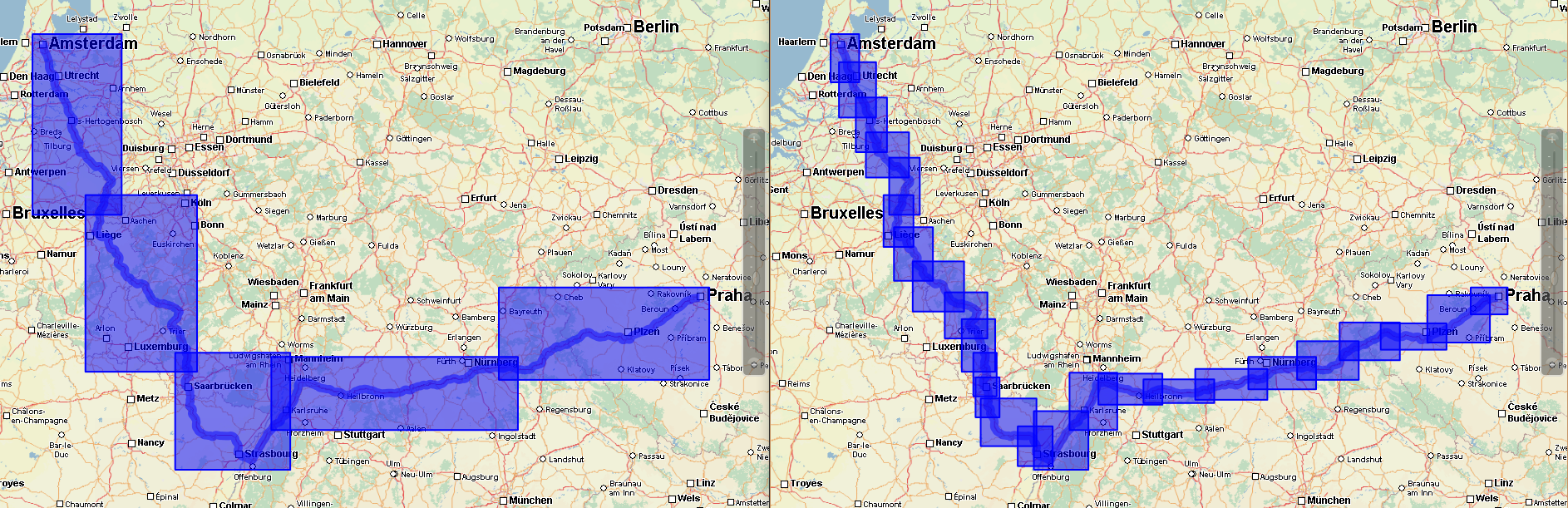

In such a case we offer an additional geographic aspect which enables you to benefit from xRoute's output which is based on drumroll boundingRectanglesC and boundingRectanglesOffset. These two parameters can be used to gather rectangles which can be part of SQL BETWEEN statements. But before I describe the parameters I show you some simple images, based on the same route.
Both routes are equal and also the corridor size of boundingRectanglesOffset=10000m is same for both maps. The difference is the number of rectangles = boundingRectanglesC. <br />left: boundingRectanglesC = 5<br />right: boundingRectanglesC= 25<br />By asking for more rectangles the overlapping area is smaller and so you can filter more candidates.

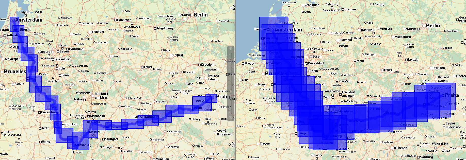

Both maps have boundingRectanglesC=25<br />This screenshot compares the horizon of the corridor: <br />left: boundingRectanglesOffset=10000m, right: boundingRectanglesOffset=50000m.
So the proper description of these rectangles is:
An object(x,y) which is NOT located in at least one of the rectangles is definetly outside an airline corridor of boundingRectanglesOffset.
That's it.
Of course the higher the number of rectangles is the more complex is the evaluation of the BETWEEN statement. But the performance of the corridor search is better afterwards. Find the trade off ;-)
