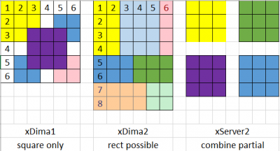

Re: calculate a large number of routes
Posted: Wed Jan 17, 2018 8:25 am
- Little comparison between xDima 1 and xDima 2.
