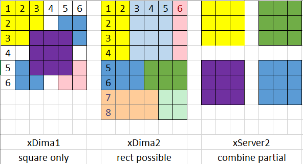

you want to calculate a 500.000x500.000 matrix? That's a freaking challenge...
With xServer2 you can slice the matrix into smaller pieces.
  • Imagine the set of coords is A/B/C/.../X/Y/Z.
  • Logically spoken you want (A/B/.../Y/Z) : (A/B/.../Y/Z)
  • Similar to union (A/B/C):(A/B/C) + (A/B/C):(D/E/F)...(A/B/C):(X/Y/Z) + (E/F/G):(A/B/C) + (X/Y/Z):(X/Y/Z)

Re: calculate a large number of routes
Little comparison between xDima 1 and xDima 2.<br />While xDima 1 is restricted to square matrices (whenever A:B is calculated we also compute B:A, furthermore we always extend the shape of a MxM matrix to an NxN matrix) the xDima 2 is more flexible. It allows you define non-symmetric rectangle shapes (e.g. list of starts differs from the list of destinations). Furthermore it is possible to retrieve the logical information of a very large matrix by simply slicing it into non overlapping areas (3. example)
