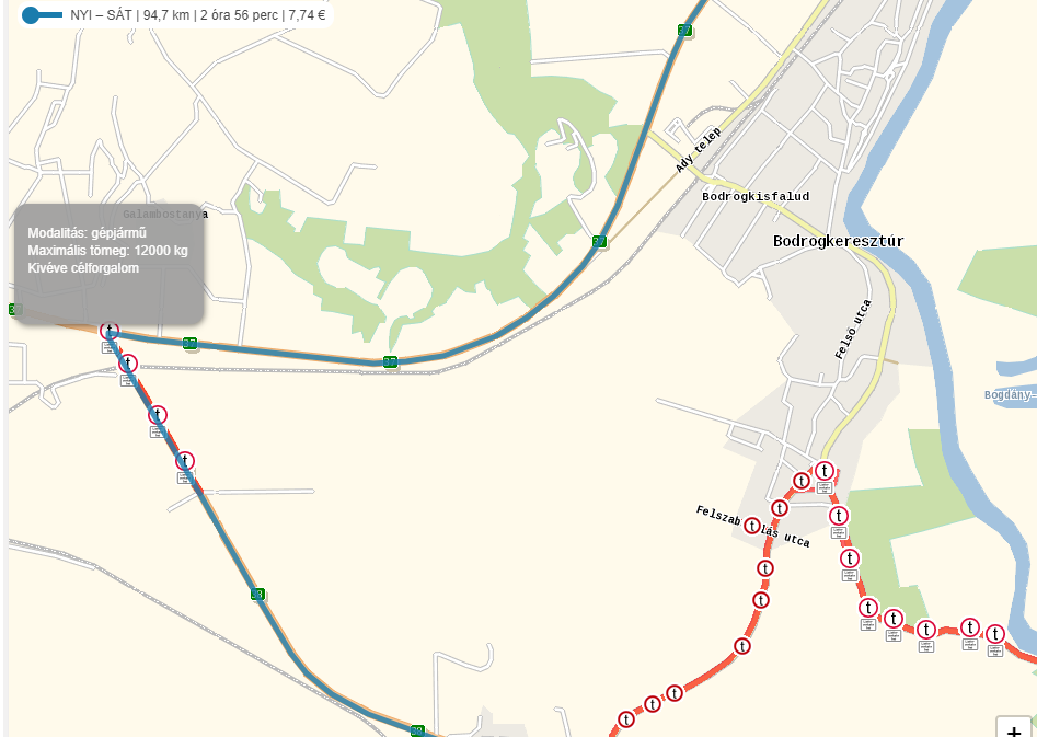

When we plan a route, sometimes we face the following issue: the route goes through roads that are restricted for deliveries even if the final destination of the tour is far from this zone apparently. We think that this phenomenon may occur because the routes in question have other attributes than 'freeForDelivery'.
See the attached image below: route between Nyíregyháza and Sátoraljaújhely (Hungary). The route goes through a section where the following restrictions are: modality (motor vehicle), max. weight (12t), free for delivery. Preferably, the route should avoid this section.

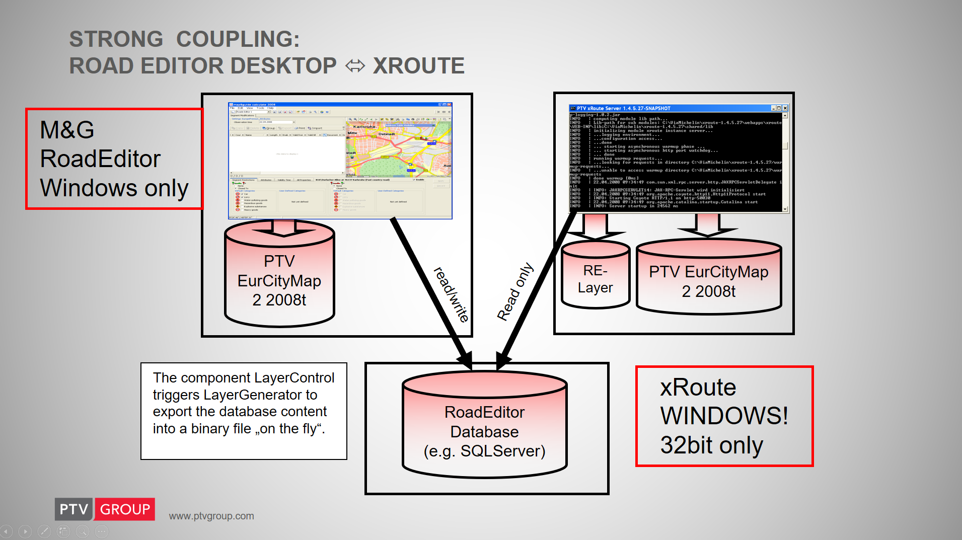

Strong coupling. The content of the original RE database is read during the routing transaction. At runtime the xServer exports required segment attributes and considers them in the routing afterwards

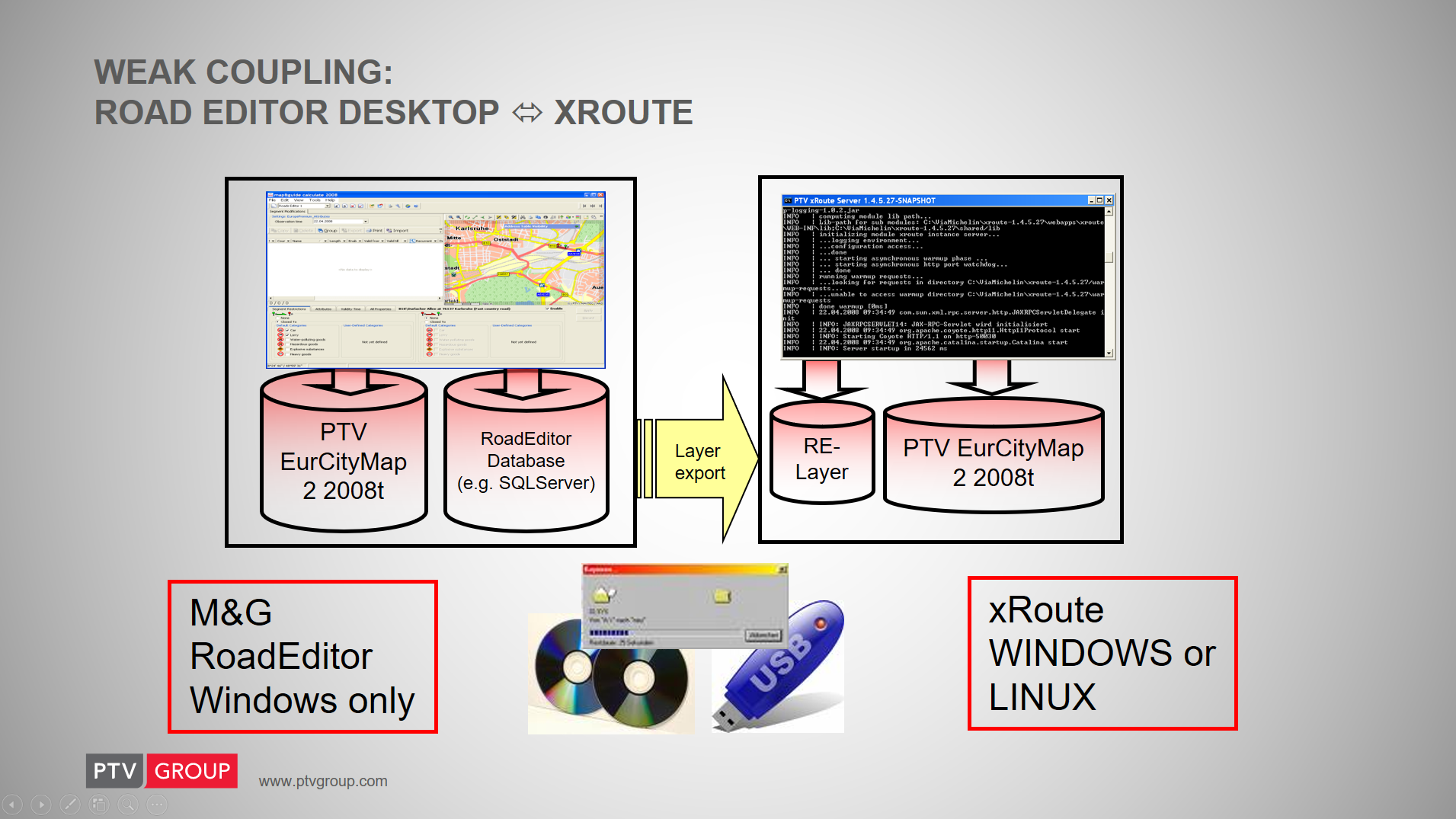

Weak coupling: the xServer isn't connected to the RoadEditor database. Whenever data has been updated in the RE database a manual export + forwarding of the binary files is required. During the export the so-called export timestamp is used to filter relevant attributes. So this approach does not consider the routing starttime. Instead of this all attributes which are in the BIN file will be relevant even if the export timestamp differs from the routing starttime.

"approved" overview of the RoadEditor. Maybe some of the slides can give you a better understanding of how to use the RoadEditor, when to use it and also about it's limitations.
