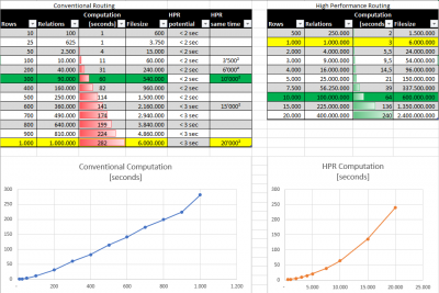

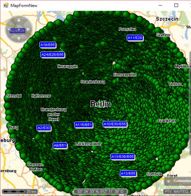

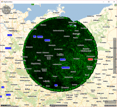

every once in a while I'm getting asked for "performance of distance matrix calculation". Here are some simple results I produced on my local machine (I7- details below - 16GB memory, xTour 1.24.0.3, HIGH PERFORMANCE ROUTING enabled). I calculated the distance matrices from scratch.
Left: times based on conventional routing<br />Right: times based on HPR<br />green lines: 60 seconds<br />yellow lines: 1000 rows

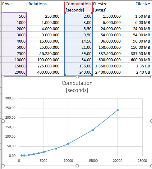

500 x 500 : 2.0 seconds
1.000 x 1.000 : 3.0 seconds
2.000 x 2.000 : 5.5 seconds
3.000 x 3.000 : 9.5 seconds
4.000 x 4.000 : 14.5 seconds
5.000 x 5.000 : 21.0 seconds
7.500 x 7.500 : 39.0 seconds
10.000 x 10.000 : 64.0 seconds
15.000 x 15.000 : 136 seconds
20.000 x 20.000 : 240 seconds
Feedback is welcome.

So it is possible to compute large sizes, it requires time (and increasing default timeouts) and FILESPACE (size(n) = n²*6 bytes, i.e. 60GB for a 100.000²).
