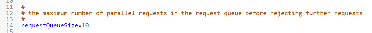

Well, the meaning of the error is simply a temporary condition of an overloaded queue:
Default queuesize configured in xserver.properties

So if an incoming request can't be handeled immediately because all available backend modules are already in use (remember: each backend module can handle a single transaction at the time) it will be forwarded to the queue but if the queue is already full (i.e. queuesize == number of waiting requests) the server returns the message Request has been rejected, as system is overloaded.

  • Increase the queuesize: if the queueing error occurs only once in a while and you don't have more ressources (neither local nor separate server) you might at least increase the poolsize which could prevent you from facing the error message. On the other hand this could lead to longer response times in case (instead of the known message) as a transaction could get into queue rank 100, 200, ... and will be forwarded to a module after getting through the queue.
