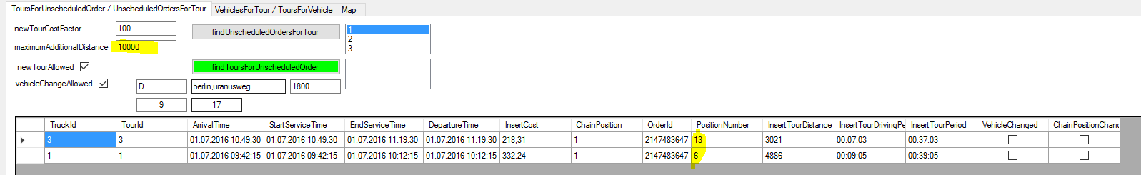

a list of the proposals which are output of the findToursForUnscheduledOrder. Not each vehicle is returned - only those where the additional driving distance is less equal than the threshold

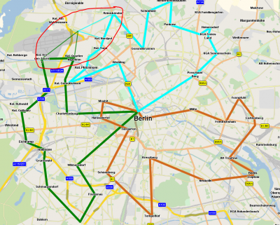

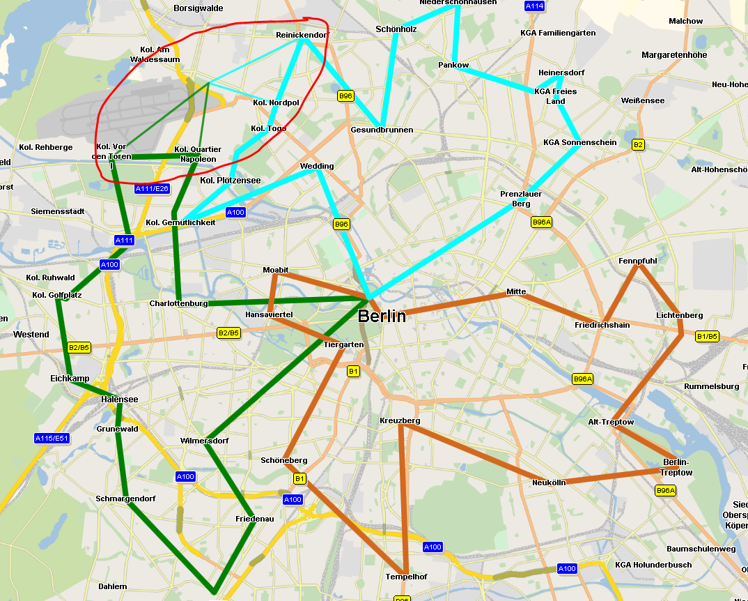

In the map you can see the two potential detours to a single new order (in the center of the red elipse). As the brown tour is too far away from the new order it does not produce a proper proposal.

hello Bernd,
thanks for the description but i have a quick question, assuming that i'm using TransportAB in my input plan, the times shown in the proposal (Arrival Time, Departure Time and Service Time) are the times of the TransportA or the TransportB
Thanks in advance
Regards
Posts: 2786
Re: Usecase: Proposal Functions
Cheerio,
I just received the answer from DEV: It is definetly the values of the A (=pickup).
to reconstruct the commplete tour structure incl. the proper arrival, startService, stopService, departure you have to assemble the input plan and then use the planBasicTours (with just the vehicle that is affected).
