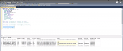

Here's a little
sample video:
-  Screenshot from the video. Shows 3 active transations in the JOB database table and 3 successfully ended ones. https://www.youtube.com/watch?v=XAaY1qd7J4A
