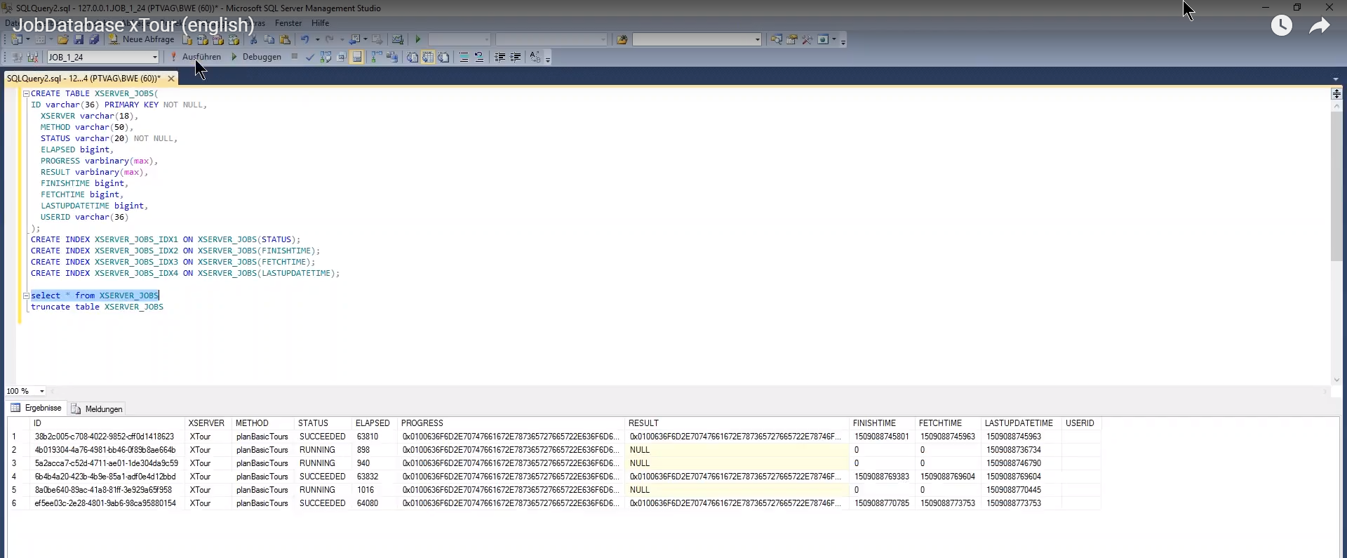

Here's an example of how to create the MS SQL database table (I used varbinary(max) instead of BLOB for some of the types).
If you
Here's a little sample video: Best regards,
I recommend to separate the JOB DATABASE from your application database. Otherwise you'd produce too many constraints with an impact on the architecture as a whole.
CREATE TABLE XSERVER_JOBS(

CREATE INDEX XSERVER_JOBS_IDX4 ON XSERVER_JOBS(LASTUPDATETIME);- use several xServers configured to use the same job database or
- set the number of backend modules to a value greater than 1 or
- both
