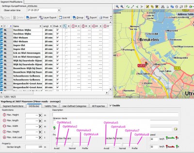

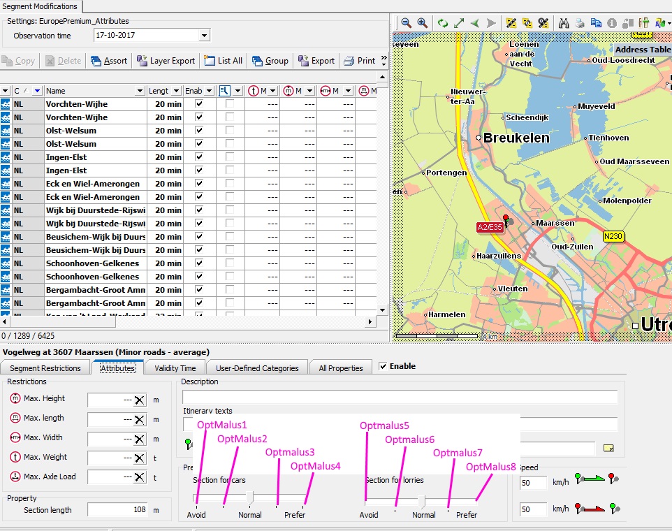

OptMalus[1-8]
These only occur if you create your own blocking layers using the Road Editor use case of Map and Guide. In the Road editor use case you have 2 sliders for avoiding / preferring segments, 1 for trucks and one for cars. Depending of the state of the slide an OptMalus attribute will be assigned to the segment. See also screenshot.
Matching of the malus values to the PTV Map&amp;Guide Road Editor settings
Matching of the malus values to the PTV Map&Guide Road Editor settings
