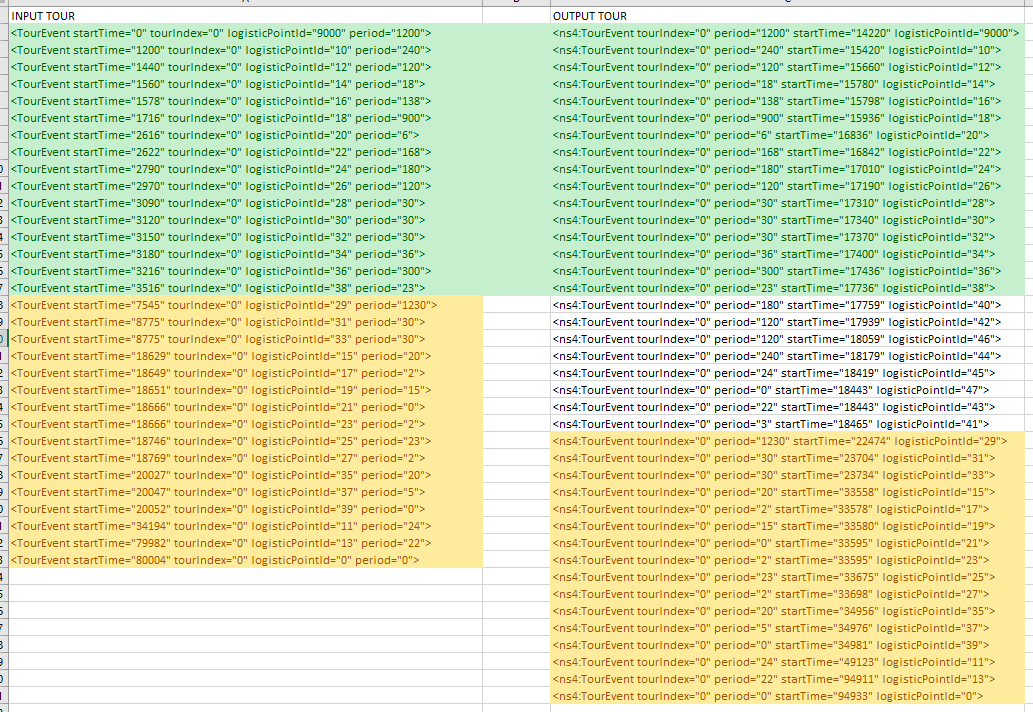

michel.request.xml
Request based on the orders 1000, 1001, ...1005. The input tour is based on a previous call and contains Depot-1003-1000-1001-1002-Depot. So the orders 1004 and 1005 are unscheduled before the call.
(31.05 KiB) Downloaded 736 times
Input tour
Input tour
michel.response.xml
The result plan is then DEPOT-1003-1000-1001-1002-1004-1005-DEPOT
(18.8 KiB) Downloaded 730 times
Output tour
Output tour

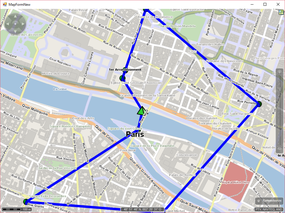

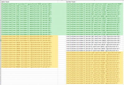

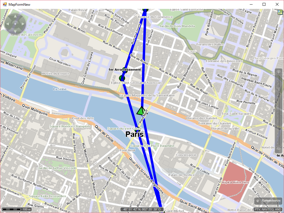

Another question about this.
In my test the new order are well added but the why the initial plan is not modified to reorder the tour points if it's better.
see xtour log attachement
Re: tour not created by xTour
Posted: Wed Oct 25, 2017 3:14 pm
Hello Michel,
from what I see in your request you deactivated all the sequencing and the improvement steps which might lead to further improvements.
then green and the bronze block are part of input and output without an change in the internal sequence.
Activate those steps and you get even better results.
