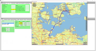

I successfully requested the ferry:
https://xroute-eu-n-test.cloud.ptvgroup ... /ws/XRoute
neutral ferry malus.<br />Time: 5h:48m <br />Distance 299km
Time: 5h:48m
Distance 299km

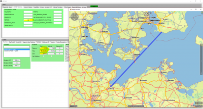

Preferred ferry by 30% (malus=-30)<br />Time: 9h:30m<br />Distance: 10km
Time: 9h:30m
Distance: 10km
Depending on the balance between distance and time (OPTIMIZATION) the ferry is less attractive even with neutral ferry malus (AVOID_FERRIES) as it produces a long period.
If the OPTIMIZATION is focused on "DISTANCE" (values around 0) the neutral ferry malus also returns a FERRY route.

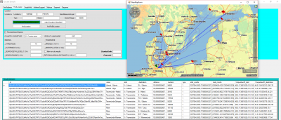

search via xLocate.findCombinedTransports
Check this...

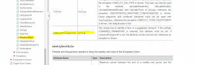

you can also seatch for potential ferries via xLocate ;-) findCombinedTransportByLocation
The ID is then a potential property of a waypoint:
WaypointDesc object accepts the ID

I tried to use findCombinedTransportByLocation, it works but I got different results than you. Can you tell me what parameters you used in this method? I tried:
    var location = xLocate.findCombinedTransportByLocation(new findCombinedTransportByLocationRequest
                    ArrayOfResultField_3 = new ResultField[] { },
                    ArrayOfSearchOptionBase_2 = new SearchOption[] { new SearchOption { param = SearchParameter.COUNTRY_CODETYPE, value = "0" },
                     new SearchOption{param=SearchParameter.RESULT_LANGUAGE,value="DEF" },new SearchOption{param=ERouteSearchType.} },
                    CallerContext_4 = new CallerContext
                        wrappedProperties = new[] { new CallerContextProperty { key = "CoordFormat", value = RouteLayerExtensions.SpatialReferenceId } }
                    Location_1 = loc,
Re: Ferry from Trelleborg to Travemunde (Lubeck)
Posted: Wed Oct 25, 2017 8:06 am
I tried this:
<Location_1>
	<coordinate xmlns="http://xlocate.xserver.ptvag.com">
		<point x="1207690" y="7151079" xmlns="http://common.xserver.ptvag.com" />
	</coordinate>
</Location_1>
<ArrayOfSearchOptionBase_2>
	<SearchOptionBase xsi:type="ReverseSearchOption" value="0" param="COUNTRY_CODETYPE" xmlns="http://xlocate.xserver.ptvag.com" />
	<SearchOptionBase xsi:type="ReverseSearchOption" value="10" param="ENGINE_TARGETSIZE" xmlns="http://xlocate.xserver.ptvag.com" />
	<SearchOptionBase xsi:type="ReverseSearchOption" value="DEF" param="RESULT_LANGUAGE" xmlns="http://xlocate.xserver.ptvag.com" />
	<SearchOptionBase xsi:type="ReverseSearchOption" value="10" param="ENGINE_MINSIZE" xmlns="http://xlocate.xserver.ptvag.com" />
</ArrayOfSearchOptionBase_2>
Maybe you are using a different map version?
