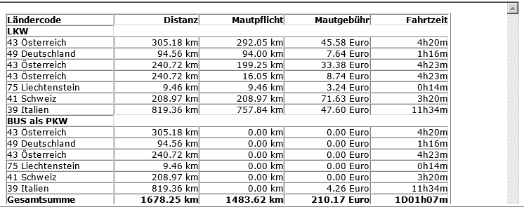

see attachement.....
i have a double Calculation for driving as a bus
1)Driving as a truck
2)Driving as a car
the route is Wien(Vienna)->Innsbruck->Bludenz->Neapel(Napoli)
i use the same parameters for both calculation....except type (CAR,TRU)
i get the toll for the truck....for A,D,LIE,CH,I
i get no toll for the car except a very cheap toll in Italy
i get no toll for car in A, CH (Vignette)
i have the following configuration for calculating the toll

ok i understand the special thing with the vignettes.
but there are 2 open things :
- the toll through 'Arlbergtunnel' between Innsbruck and bludenz
- the toll in the italien autobahn from border of CH to napoli
i got from Como(Border CH/I) to Napoli a toll of EUR 62,45 , on my picture is shown EUR 4,26

Hello Andreas,
just found this orphaned post about toll. Is this a topic where I can help?
Tunnels with SPECIALCHARGE are part of our data of course.
