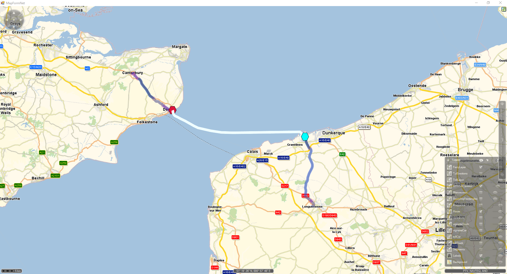

in a combined transport, is it possible to visualize the segments that were driven by rail and/or ferry on the map? For example a road is marked till main station vienna, and then the railway tracks are marked from vienna station to munich station.

Hello Niko,
as with other object categories as well you can get the "isPiggyback" or "isFerry" for each segment in the result list.
As you know the polygon points of each segment (firstPolyIdx and polyC), you can determine the relevant part and create the required subpolygon.
Is this what you've been looking for?
