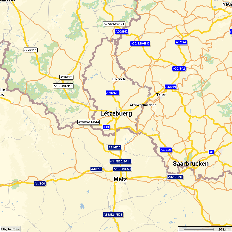

Our customer asked us whether there is any possibility to visualize the borders on the map with a thicker line because a few users can not see the thin marked lines between the countries if they are zoomed in into the map.
Could you help us in this topic?

you can display an image like this
rendered with the special render ini file
The required section looks like this:
; PROPERTIES BACKGROUNDS
; THIS CONFIGURATION SETTINGS ARE USED FOR ALL COUNTRIES, WHICH ARE NOT LISTED IN THE SECTION [config.background.countries]
[config.background]
; The key borderwidthfactor key is multiplied by the border width.
; If you set the value borderwidthfactor=2.0, the border width is multiplied with 2.
;borderwidthfactor=1.000000
borderwidthfactor=25.000000
scaleareasort=50.000000
That's it,
ok with that?

[config.background.countrycode]
[config.background]

[config.background.region.width]
; River
number32=4
regions32=5.000000,20.000000,80.000000,
width32=2,1,1,1,
; Rail
number33=3
regions33=1.000000,30.000000,
width33=3,3,1,
; Country border
number34=30
regions34=0.210000,0.260000,0.300000,0.360000,0.440000,0.500000,0.570000,0.630000,0.700000,0.800000,0.900000,1.000000,1.050000,1.110000,1.170000,1.250000,1.330000,1.420000,1.530000,1.660000,1.800000,2.000000,2.220000,2.500000,2.850000,3.300000,4.000000,12.000000,80.000000,
#width34=100,82,71,60,50,45,40,36,33,30,27,25,24,23,22,21,20,19,18,17,16,15,14,13,12,11,9,7,4,0,
width34=1000,820,710,600,500,450,400,360,330,300,270,250,240,230,220,210,200,190,180,170,160,150,140,130,120,110,90,70,40,0,
; Federal border
number35=30
regions35=0.210000,0.260000,0.300000,0.360000,0.440000,0.500000,0.570000,0.630000,0.700000,0.800000,0.900000,1.000000,1.050000,1.110000,1.170000,1.250000,1.330000,1.420000,1.530000,1.660000,1.800000,2.000000,2.220000,2.500000,2.850000,3.300000,4.000000,12.000000,20.000000,
width35=97,79,68,57,47,42,37,33,30,27,24,22,21,20,19,18,17,16,15,14,13,12,11,10,9,8,7,5,3,0,

[config.background.region.width.inner]
; Country border
number34=2
regions34=20.000000,
;width34=1,1,
width34=5,5,
; Federal border
number35=2
regions35=80.000000,
width35=1,0,

; Country border
34=14341119
;34=255
; Federal border
35=255
