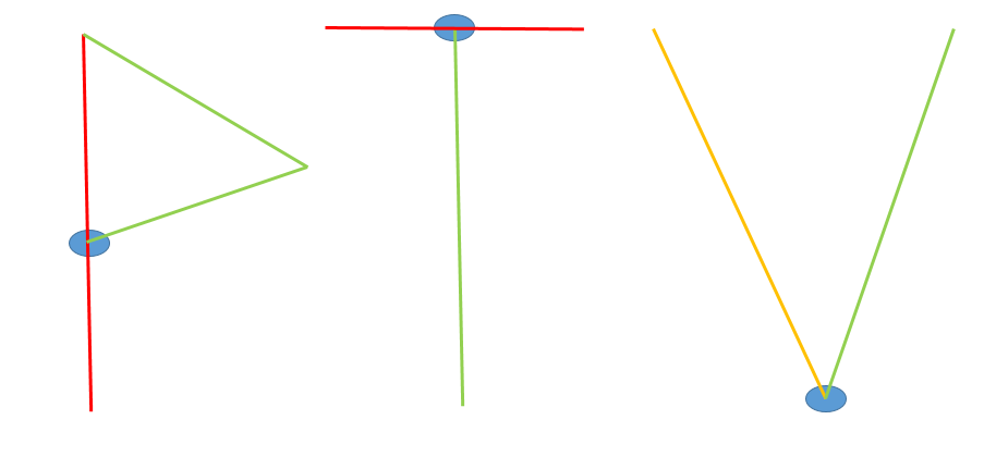

Well, from my point of view I'd describe a segment as a sequence of points (sometimes just two, sometimes more) that is not interrupted by a crossing...
P : the center of the left bar cannot be handeled as a single segment because it is connected to another element and therefore contains a crossing<br /><br />T : The top bar has to be treated as two segments as there is another 3-element node<br /><br />V : Could be seen as a single segment (without a node) or two separated segments.

Oh and there is another criteria (Thanks to our data expert Thomas E.) :D :
  • A segment is a unit created by one of the data providers. The provider partitions the digital network based on his own rules.
  • A segment is a unit which is based on the application of ISO certificate GDF based on defined critreria.
  • Though a crossing is an important base object that has influence on the segment endpoints it is not the only one: changes of attributes on a segment (speed limits, streetname, linked to different administrative base element ...)
