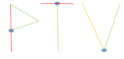

Well, from my point of view I'd describe a segment as a sequence of points (sometimes just two, sometimes more) that is not interrupted by a crossing...
P : the center of the left bar cannot be handeled as a single segment because it is connected to another element and therefore contains a crossing<br /><br />T : The top bar has to be treated as two segments as there is another 3-element node<br /><br />V : Could be seen as a single segment (without a node) or two separated segments.
