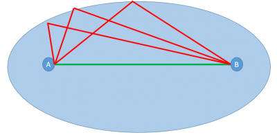

You want something like the blue ellipse, the geometry?
- "Distance" between A and B is smaller than the available horizon, so there is a search space to be reacheable
I assume we don't have a function for this but maybe you can use some simple (A:N) + (N:B) matrix requests?

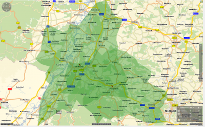

- Two 30min isochrones, checking for 1 hour.
Any point outside both isochrones will not be a candidate for the given task.
Any point inside both isochrones is reacheable within 60 minutes.
Attention: doesn't guarantee anything for points inside exactly one isochrone.

First I'm doubting in quality of results. Yes, in your example, any point inside both isochrones is reachable within 60 minutes but we miss a lot of points (as you said, points inside exactly one isochrone may match the condition).
The only way I see to get a maximum of points is to populate an union of isochrone intersections. Going back to your example, we have to calculate the intersection of isochrone(Karlsruhe, 5 minutes) and isochrone(Pforzheim, 55 minutes), the intersection of isochrone(Karlsruhe, 10 minutes) and isochrone(Pforzheim, 50 minutes), etc. and then populate the union of these intersections. But I'm doubting in performance if we populate this union...
Finally I wonder if it's not faster to slice my map into rectangles, to calculate the distance matrix between all the centers of these rectangles and then identifying all the rectangles that match the condition. It may be faster but not easier because slicing the map is an hard work
What do you think about that ?

And you can still calculate an airline ellipse to filter the candidates C for a later validation.
The (A:C)+(C:B) routings should then be performant enough...

Here is a map example
Yeah good idea! I could first define the area with two isochrones and then calculate the "squared" ellipsochrone with (A:N) + (N:B) matrix requests.
