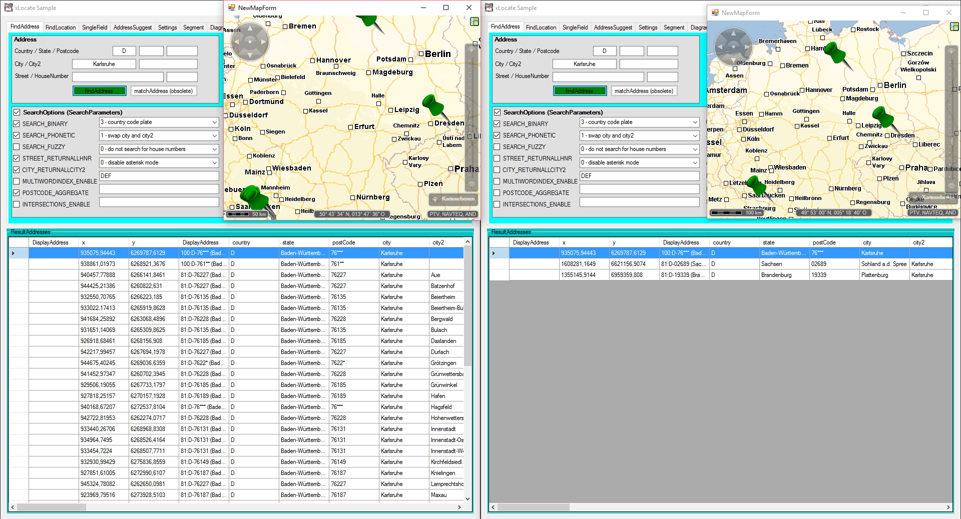

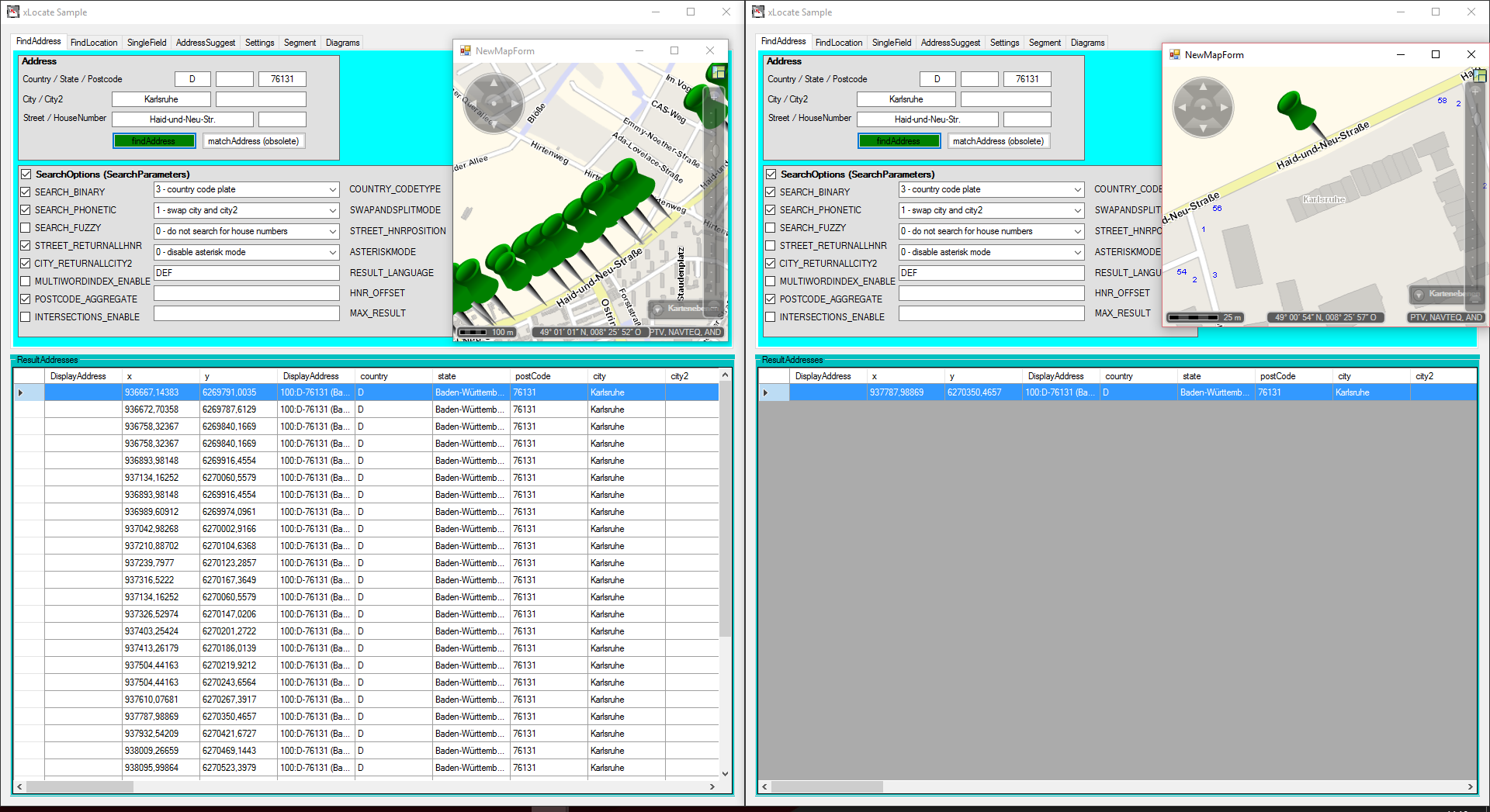

sure, you can provide complete input patterns or just subsets or properties.
Depending on the search options the result is a list of alternatives or just a single representant:
This is also described in this post:
http://xserver.ptvgroup.com/forum/viewt ... f=11&t=586 Best regards

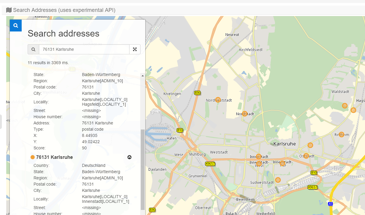

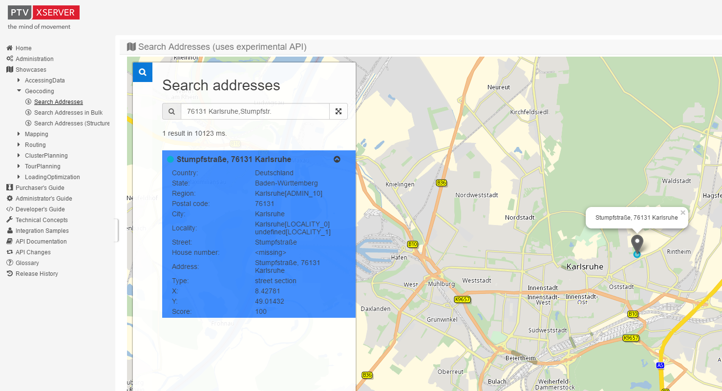

Here we go:
There are no parameters given - we try to identify the users requirement.
This is how it looks like in xServer 2.There are no parameters given - we try to identify the users requirement.
