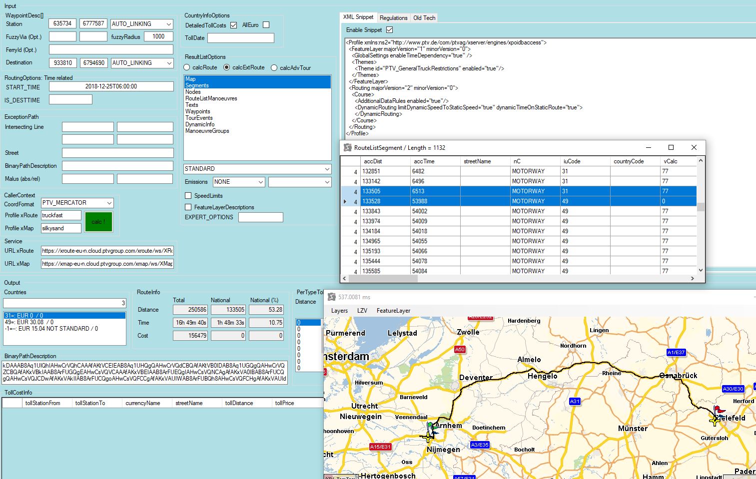

Hi, any update on this? I just tried routing in Germany on 25.12 this year, when truck driving should be forbidden from 00-22, but routing worked fine. I enabled PTV_GeneralTruckRestrictions layer in the request.
What should happen there anyway, route start or end is in restricted country? Just error message?
Re: public holidays during routing
Assuming you are routing to an area witch is covered by general truck restrictions: The route will be calculated but the travel time will be quite large. On the segment at the border you will see that essentially the truck will take as much time as needed until the road opens up again.
