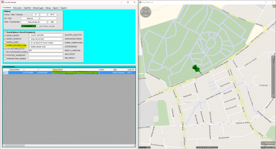

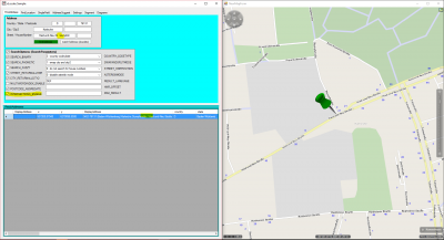

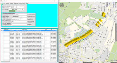

Hello Mr. X,
you can easily use the available SEARCH_OPTION-Class to influence the geocoders behaviour in the usecases you described:
- If the housenumber of the input address isn't found in the data we return a set of housenumber ranges
- ... otherwise we return the reference coordinate of the street as a whole
About the second topic you mentioned:
crossings. This is also possible:
- Here I used the SEARCH_OPTION "INTERSECTIONS_ENABLE" which activates the useage of several potential separators specified in the native profile.
The native profile provides the following configuration parameter for the separators (among others). A separator is a charatcer or string that separates the involved streets from each other:
<Intersections.Separators Value="/¤\¤ at ¤ @ ¤ ecke ¤" Type="string"/>
So much for the moment!
