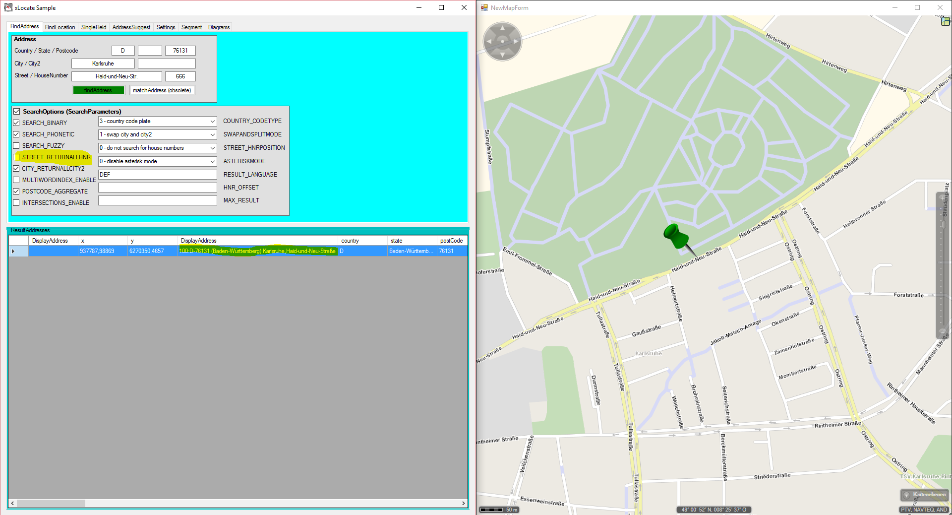

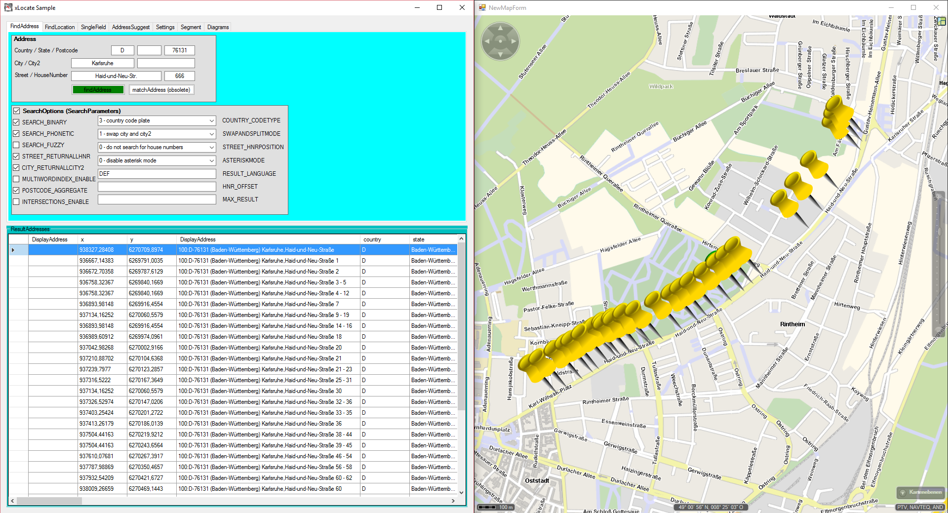

When looking up addresses there are a lot of parameters to influence result list. E.g. it is possible to get all house numbers for a street or even the reference point of the street.
I'm facing the problem that one of my customers likes to find a crossing and NOT a specific house number (or building).
Is it possible to get the geographical coordinates of a crossing or the crossings on a specified street?
Hopefully this is feasible!
Who is able to assist?

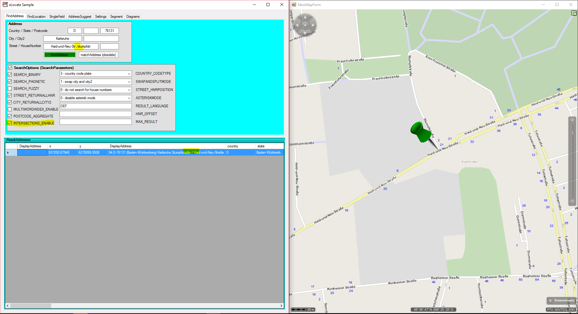

Hello Mr. X,
you can easily use the available SEARCH_OPTION-Class to influence the geocoders behaviour in the usecases you described: About the second topic you mentioned: crossings. This is also possible: The native profile provides the following configuration parameter for the separators (among others). A separator is a charatcer or string that separates the involved streets from each other:
So much for the moment!
<Intersections.Separators Value="/¤\¤ at ¤ @ ¤ ecke ¤" Type="string"/>Best regards,
