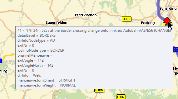

with the info you already mentioned (the Manoeuvres) you have access to various generic attributes. For example you can retrieve the index of the border segments, crosscheck the polygon coordinates and visualize the crossing in a map.
What info would you like to gather? Maybe we can help you to describe where to find it?

How about this?
