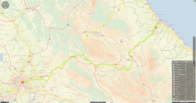

- Total track PESCARA to ROMA. Red circles show a change in the Network Class, e.g. from TRUNK ROAD to HIGHWAY. So a very long part of the track is HIGHWAY.

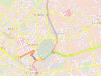

- ...and in the west in ROMA.

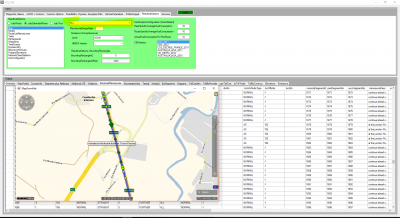

turned out that the solution for Gianbattista's issue is the ResultListOptions.DETAIL_LEVEL of the manoeuvres:
By setting it to ALL the response contained the required highway elements.
- Screenshot via XRouteToll testclient
They were missing because the STANDARD level only returns real manoeuvres where drivers have to change roads or lanes.

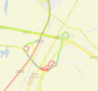

I added different colors (based on locInfoNodeType) and size (detailLevel) in my manoeuvres layer.
