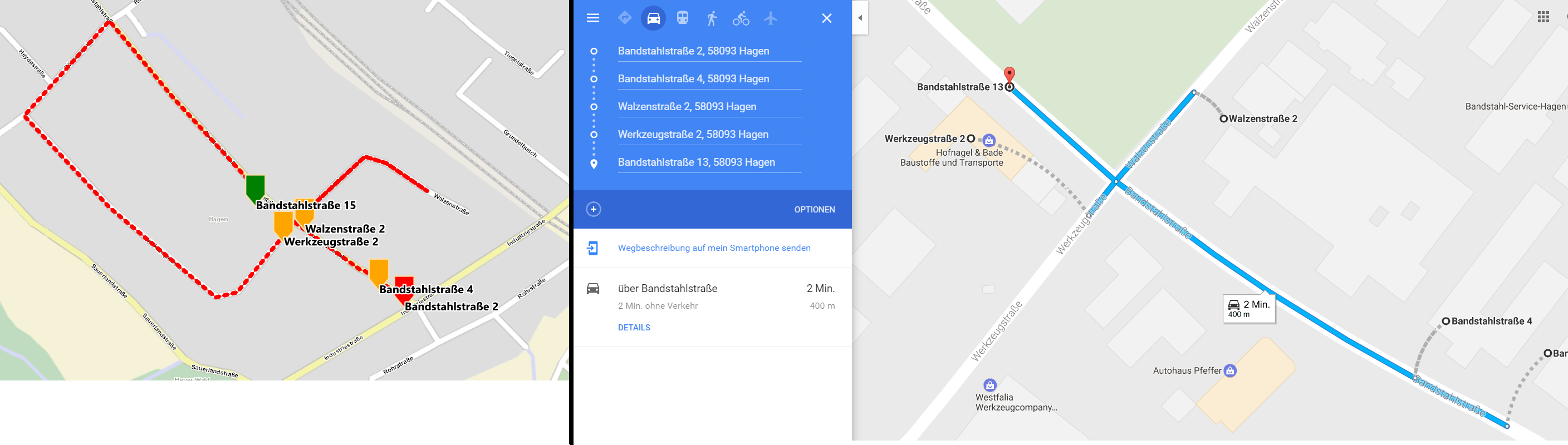

I was comparing some results of the calculateRoute from your xRouteService with the GoogleMaps Service.
And I am a little bit confused, since I am receiveng a small detour based upon xRoute.calculateRoute(...). The xRoute calculated Route has a length of approx. 2,2km, the Google Maps has a lenght of 400m.
Why do I have such a detour? I would assume, more or less, the same result as from Google Maps.
PTV xRoute.calculatedRoute() vs Google Maps.Route()
On the left side: xRoute.calculatedRoute(...)
Red Marker = Start
Orange Marker = Via
Green Marker = Destination
On the right side: Google Maps()
Addresses:
Street + HouseNumber; Plz;City
Bandstahlstraße 2;58093; Hagen;
Bandstahlstraße 4;58093; Hagen;
Walzenstr 2;58093; Hagen;
Werkzeugstraße 2;58093; Hagen;
Bandstahlstraße 15;58093; Hagen;

Did you set the viaType on the intermediate points?
If you do not specify a viaType xRoute default to VIA. this means xRoute assumes you are staying on the road and will avoid making a U-turn. If you set the viaType to VIA_STOP, xRoute assumes you are leaving the road and this after the point can go back into the direction you came from.
For more details please check the API documentation.
