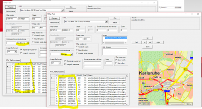

				Re: Result of renderMapBoundingBox, wrappedObjectsField prop
				Posted: Tue May 23, 2017 3:59 pm
				As the string returned as "objectInfo" is rendered at feature layer design time (on data center) we do not know whether you requested the map tile in OG_GEODECIMAL or PTV_MERCATOR or whatever: It is simply stored in PTV_SMARTUNITS.
But:
If your mapping interface works with OG_GEODECIMAL you can have a look at the ObjectInfos X,Y-Coordinate property:
-  comparison between different coord formats
