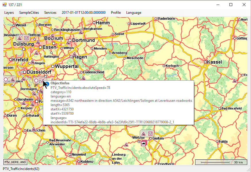

Is it possible to have different information? Like the coordinates of an accident or the length of the traffic jam and obviously its position?
Thank you again

Hello G.,
you can retrieve information about the traffic incidents by xMap and xRoute:
xMap : gather the object infos Another approach is based on the route list segments and the featureDescr-property of the segments: Works fine with me
Is this answer what you need?

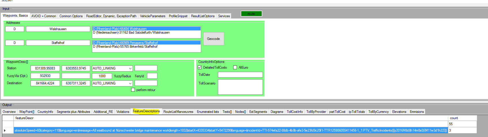

Re: Routes in past - is historical considered for calculatin
I'm having some problems with featureDescription: sending the same request, sometimes I receive the featureDescription and sometime no. The request is always the same. Do I need to check something on my server configuration?

Hello G.,
Maybe there's some issue with the content update service?
Do you always connect to the same service?
Or is it a load balanced instance?
As this requires some 1:1 handling I recommend to get in touch with support.
