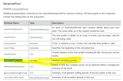

we would also like to provide the remaining driving hours for a driver to call calculateAdvancedTour(). I found an example in a public log-file on the web:
"remainingPeriods":
"22 serialization::archive 9 0 2 0 0 1 3 0 3 0 0 0 0 16200 0 0 0 1 0 39600 0 288000 0 0 3 2147483647 2147483647 2147483647 0 0 0 0 0 1 0 0 0 288000 0 0 892800 0 0 288000 0 0 6 0 0 0 288000 0 0 0 0 0 0 0 0 0 3 0 0 34388 2147483647 0 34388 0 4 0 16200 900 1800 0 39600 10800 32400 32400 3 32400 36000 2 604800 86400 0 518400 201600 162000 324000 345600 0 1800 2700 21600 32400 900 28800 172800 39600 0 0 0 0 0 0 0 0 0",
but dont know how to interpret that in detail.

the string itself is not documented and the interface is simply able to understand the remaining periods that are returned by a previous routing.
- Remaining Periods as part of the output of a previous calculateAdvancedTour
From my current understanding, the documentation or simplification of such a parameter isn't part of future xRoute 1.X versions but a hot topic for xTour 2.

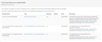

nothing you can test so far but work is in progress.
Here's a little experimental teaser
- Upcoming... ExecutionState...
Let's see wether 2.14 will already offer this.

just found this post. In the meantime we added a lot more flexibility to the topic "break- and rest rules"...
Drivers work logbook, flexible rules, configurable working hours and more
Check the
API doc!
