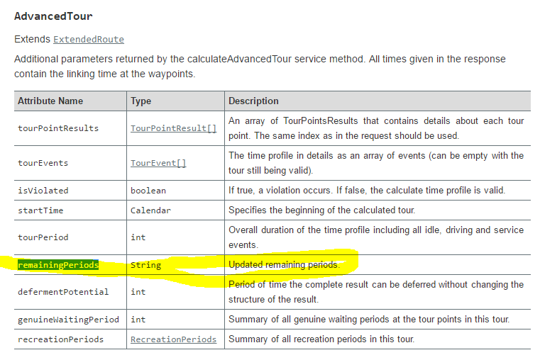

Re: How to construct REMAINING_PERIODS for realtime planning
we would also like to provide the remaining driving hours for a driver to call calculateAdvancedTour(). I found an example in a public log-file on the web: but dont know how to interpret that in detail.
Given a driver regulation that says that after 4h driving there is a 1h break, I want to call the calcAdvancedTour with e.g. remaining drive time 2h. The expected behaviour then is that for the first section the driver has 2h of driving left followed by a 1h break and then again 4h driving.
Thank you!
"remainingPeriods":
"22 serialization::archive 9 0 2 0 0 1 3 0 3 0 0 0 0 16200 0 0 0 1 0 39600 0 288000 0 0 3 2147483647 2147483647 2147483647 0 0 0 0 0 1 0 0 0 288000 0 0 892800 0 0 288000 0 0 6 0 0 0 288000 0 0 0 0 0 0 0 0 0 3 0 0 34388 2147483647 0 34388 0 4 0 16200 900 1800 0 39600 10800 32400 32400 3 32400 36000 2 604800 86400 0 518400 201600 162000 324000 345600 0 1800 2700 21600 32400 900 28800 172800 39600 0 0 0 0 0 0 0 0 0",
Thank you!
- Posts: 3040
Hi together,
the string itself is not documented and the interface is simply able to understand the remaining periods that are returned by a previous routing. From my current understanding, the documentation or simplification of such a parameter isn't part of future xRoute 1.X versions but a hot topic for xTour 2.
Best regards Bernd Welter

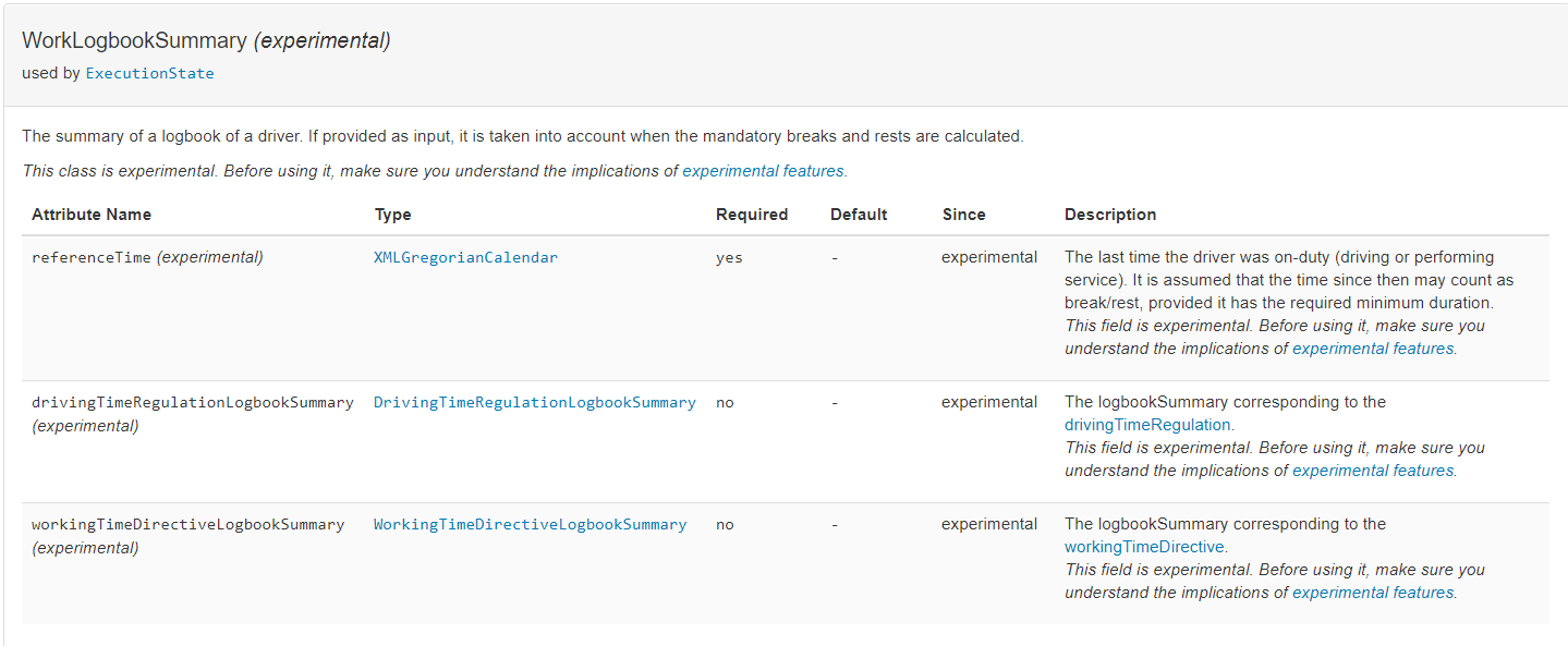

- Posts: 3040
just found this post. In the meantime we added a lot more flexibility to the topic "break- and rest rules"...
Drivers work logbook, flexible rules, configurable working hours and more
Check the API doc!
Check the API doc!
