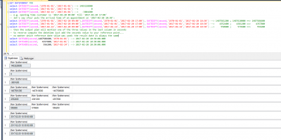

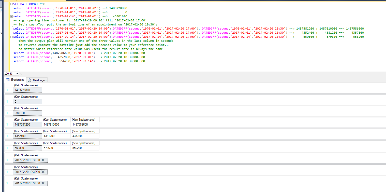

I hope the screenshot here demonstrates what I meant.
- Three different reference dates - all produce same result ;-)
